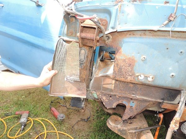

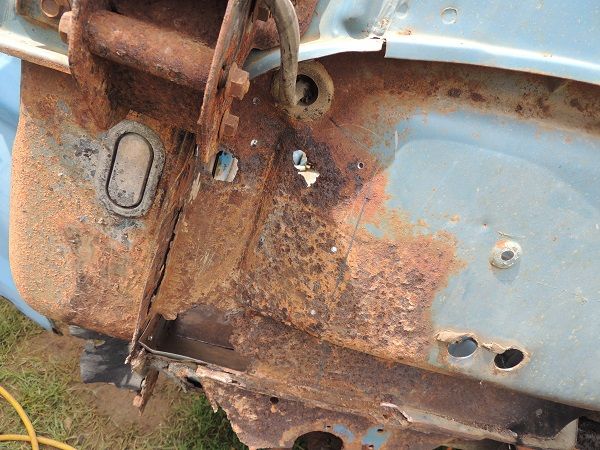

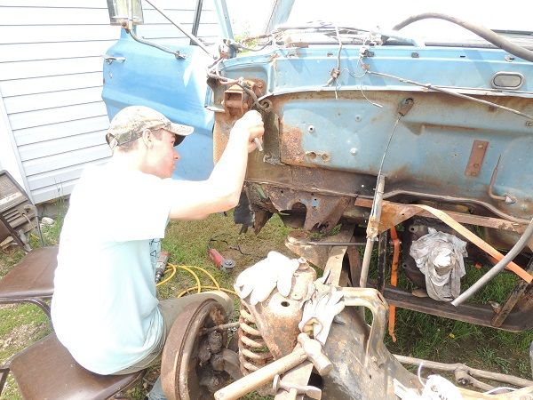

Earlier today my dad and I started working on the cab mounts, if you can even call them cab mounts anymore. We made up a pattern for the pass. side, and also started working on patterns for the kick board and the parts of the floor pans that need replacing. There is going to be a lot of fabricating and welding, but it its worth it.

Wow!! I have never seen cab mounts that rotten. Kudos to you for taking on the challenge!

These are the best cab mounts you can get. Kinda pricey, but they are the original style, not the cheap stamped ones from China.
http://dennis-carpenter.com/trk67-79cab ... ng/c/1223/
You might also want to consider doing the floor pans if the cab mounts are THAT bad:
http://dennis-carpenter.com/trk67-79floor-pans/c/1219/

flyboy2610 wrote:These are the best cab mounts you can get. Kinda pricey, but they are the original style, not the cheap stamped ones from China.

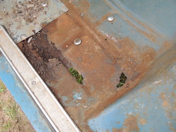

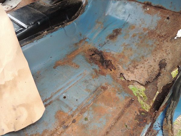

The floor pans are definitely in need of repair...
Driver's side
To keep costs down, we are going to fabricate the cab mounts and floor pan patches our self . It will take some time, but it will be worth it.

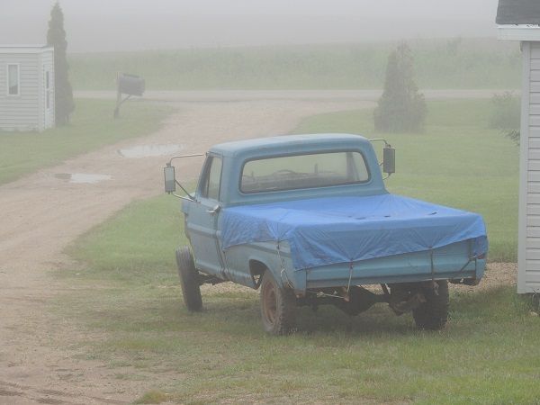

This is a depressing picture...
Way to damp to work on anything right now. Rain for the next few days also, so the truck sits until nicer weather comes.
(the truck is up on blocks.. that is why it sits so weird..)
Here is a pic of the farmer fix cab mount floor pan combination

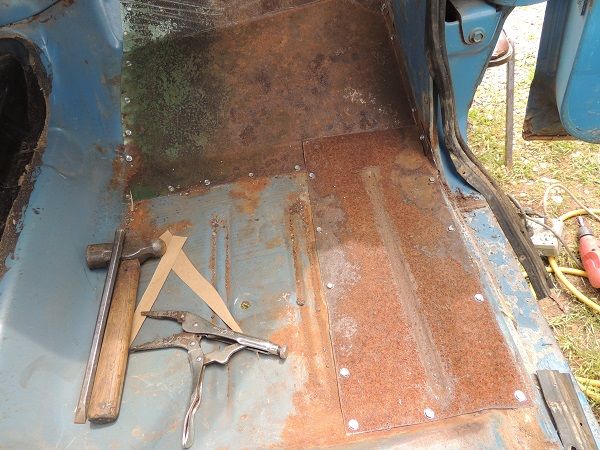

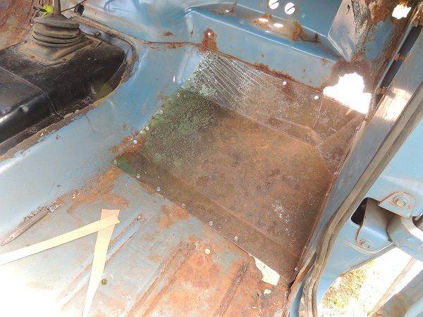

For some reason there was no rain today, and the sun actually came out! With that comes some updates on the truck.
The pattern for the pass. side toe board was already made a few days ago, so it was cut out and formed today. It is made out of a car roof from a 1953 Dodge. It was fairly easy to fabricate.
Here is the toe board fitted in place, ready to be welded
Also made the lower floor pan patch pattern, cut it out from the sheet metal, and now it is also ready to be welded
The fire wall by the heater core needed work also...
Here is the patch for the fire wall
Me fitting the patch...

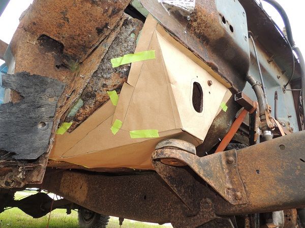

Also finished the pattern for the cab mount. Everything will be sealed completely, so no water can get in. It is also going to be attached right to the rocker panel to add strength. It should be built better than factory.

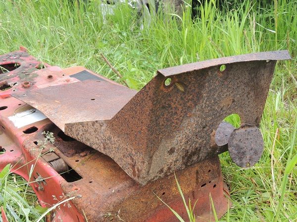

That's all for now
