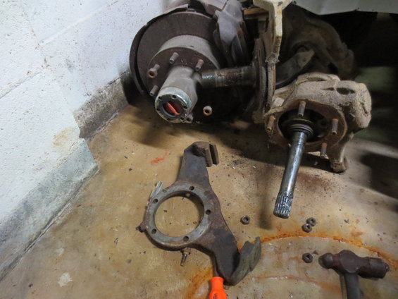

I got whacked by the cruds myself it kicked my rear for the past 2 weeks on off. Did get a chance to get you some better info. The brake spiders i have here are 60's they fit on the 44 hubs and appear to be fine. The only thing is the inner bore is bigger so it does not fit precisely on the 44 hub. the hub will pass thru and sandwich it hard and the hub will be piloted into the knuckle. Once you get it bolted and setup i see no reason it will hurt your. The hub pilot does not anchor it it's all on the studs to hold it from spinning. As the d44 spindle will still pilot in the knuckle you should be good. They are rusty but solid i will blast them clean if you want before they head your way. Tell me what you think...hfdco4 wrote:So I got the Diff Cover off the Front Axle finally. It looks pretty good inside so as soon as I get the U-joint done in the axle I can get it put back together. As soon as I got started I got side tracked. Came down with a cold that is kicking my butt. So the time I took off work is now trying to get better.![]()

Let me get a little better and look at what I am doing sir. Thanks for the pics as they look to be what I need.

hfdco4 wrote:Let me get a little better and look at what I am doing sir. Thanks for the pics as they look to be what I need.
No problem heal up first. They ain't going no where. Maybe the blast cabinet but nowhere else. Think they will get your axle sorted out.
