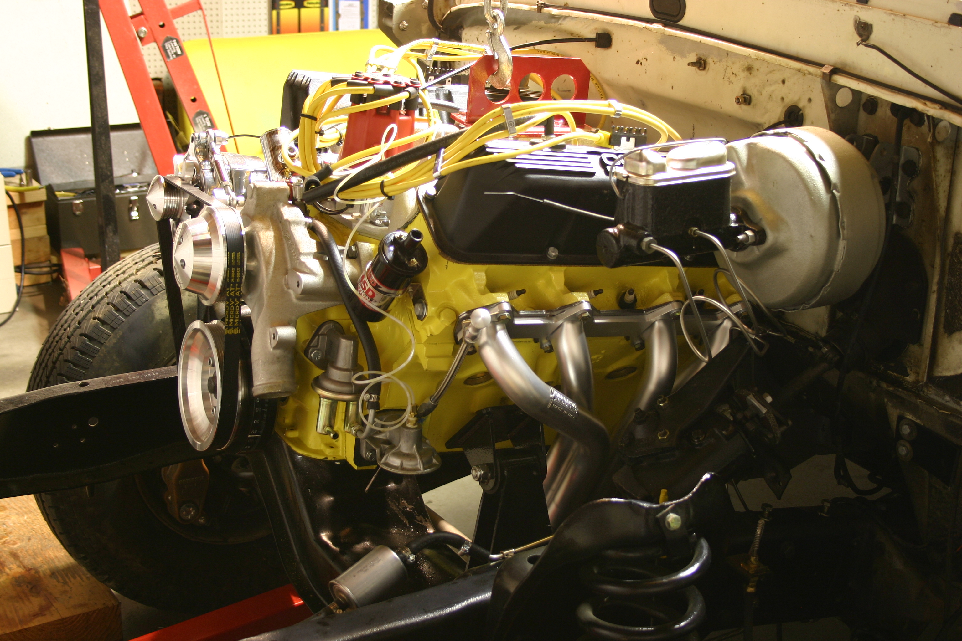

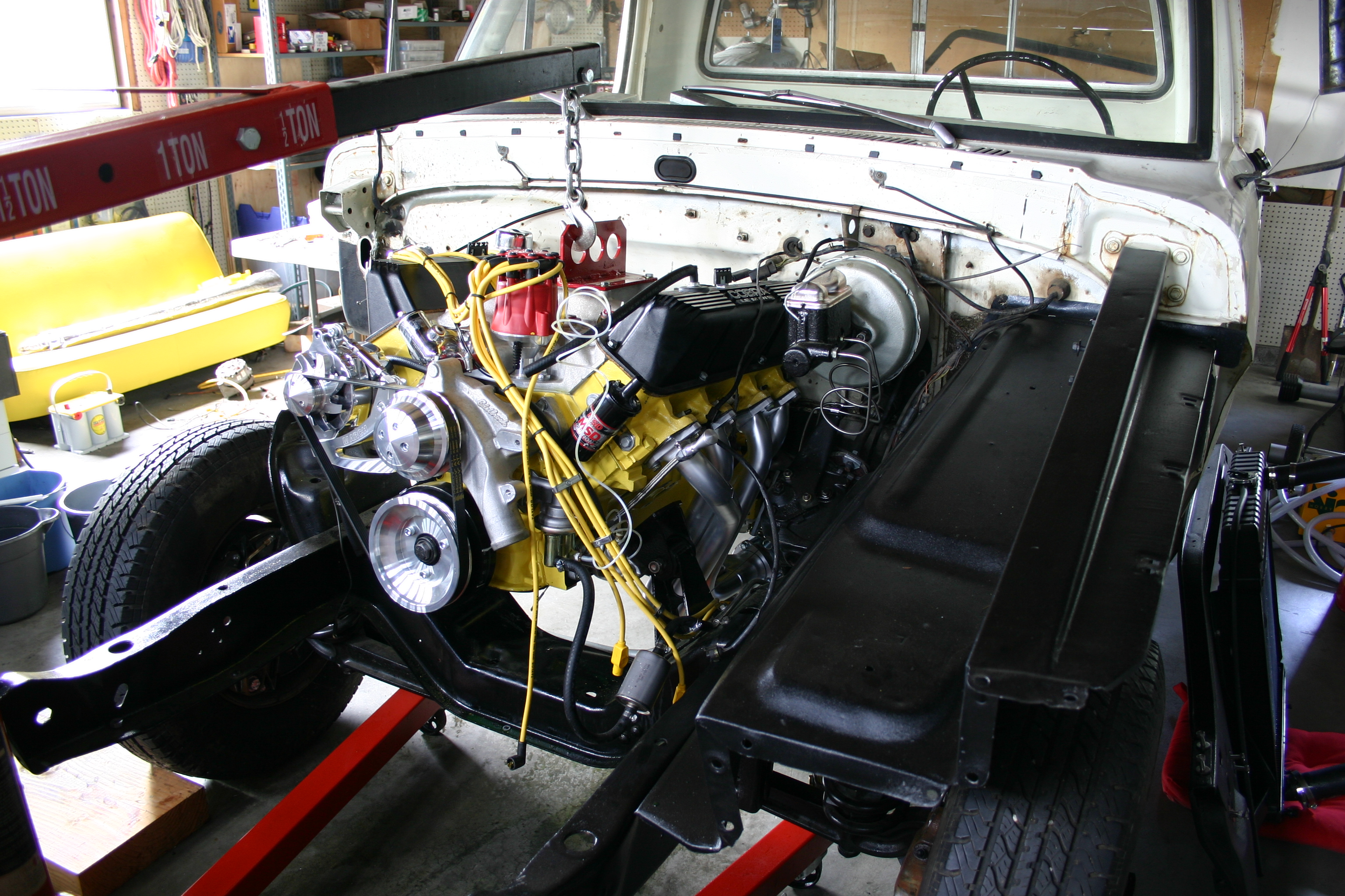

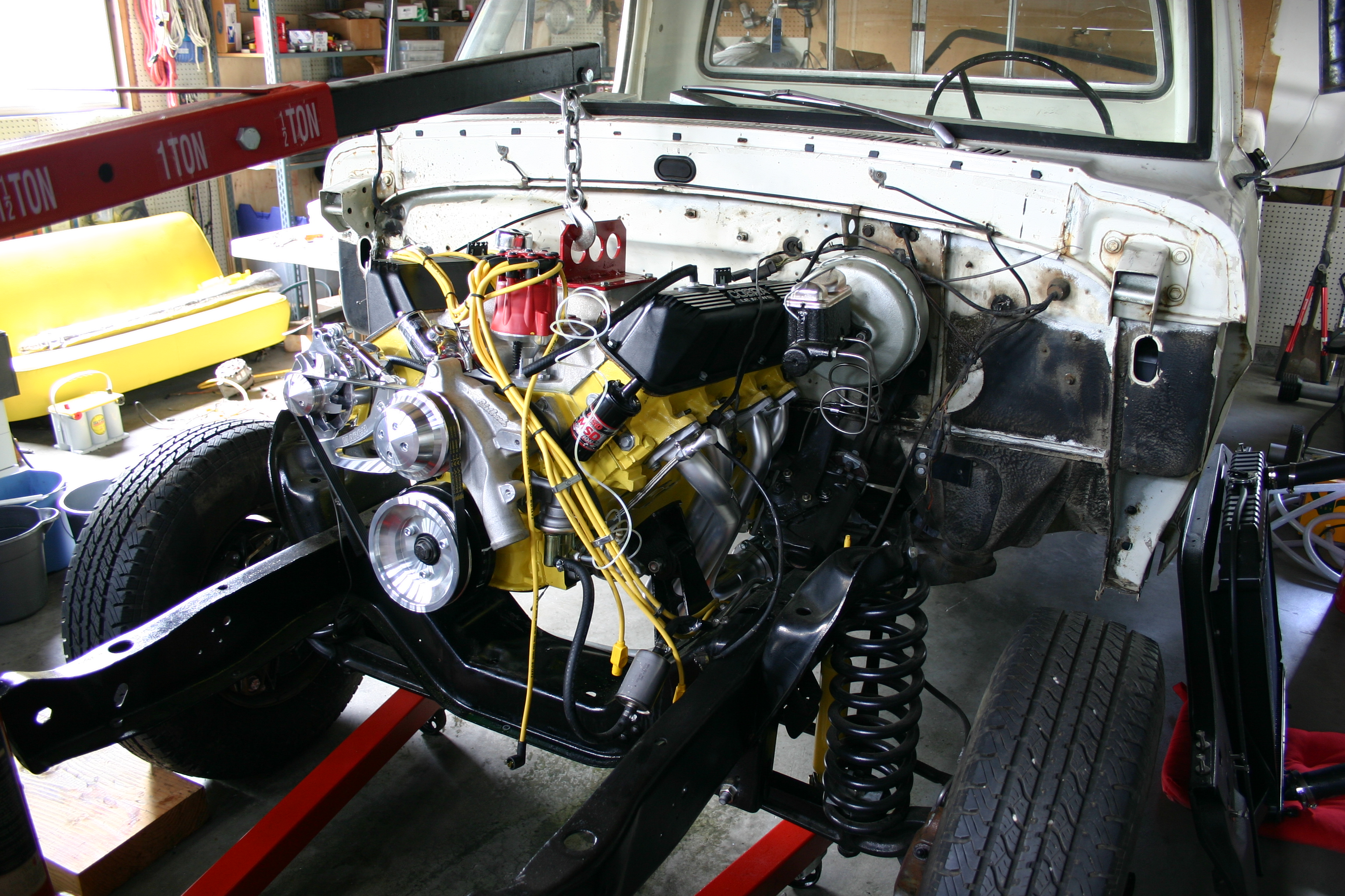

Here's the first update of the day:
Before beginning for the day:
http://www.robroygregg.com/Number50/IMG_4534.JPG
I disconnected all the wires and pulled off the right side apron:
Then pulled the left side apron:
The clutch linkage removed:

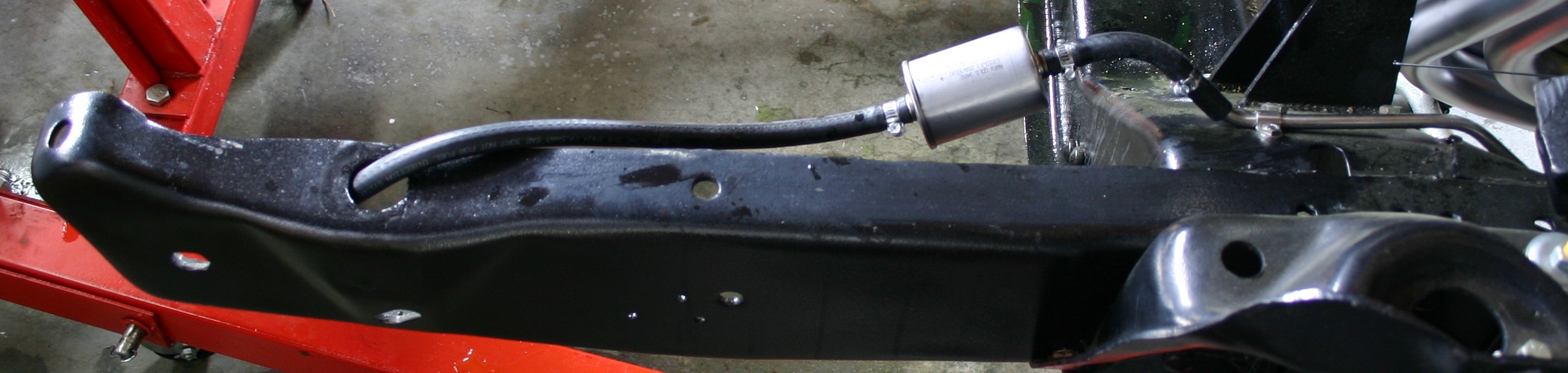

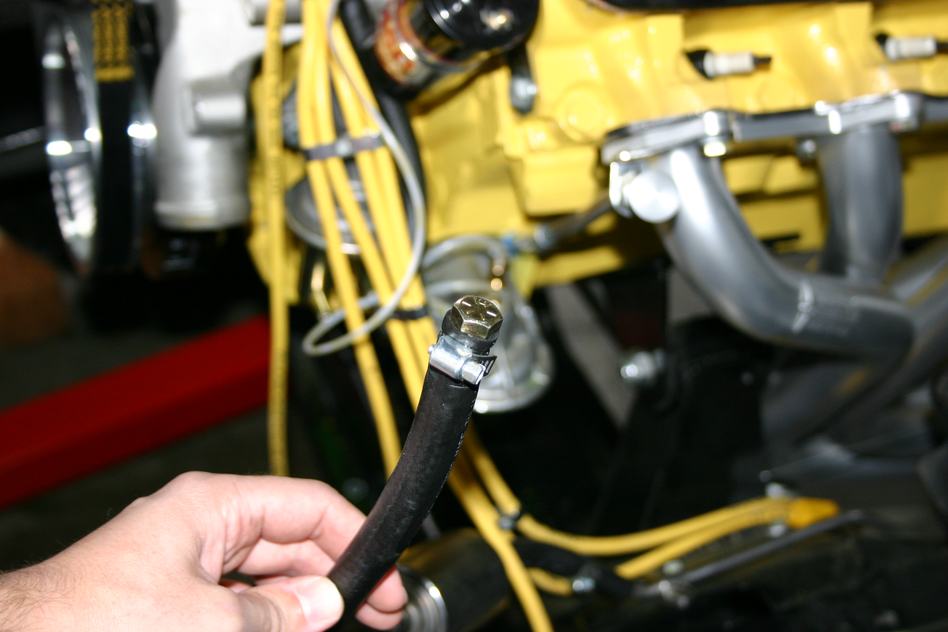

Here's what I did to cap off the fuel line--I managed to only spill a little bit. I wish I'd been this thoughtful when disconnecting the radiator!
http://www.robroygregg.com/Number50/IMG_4549.JPG
Here's how I set the fuel line out of the way. Do you guys like that nice fuel filter I put there? It's from NAPA.
http://www.robroygregg.com/Number50/IMG_4553z.JPG
And for now, I left everything loaded on the aprons and set them in the bed:
http://www.robroygregg.com/Number50/IMG_4543.JPG
Thanks for reading! Now I'll get back to work!

Note on the filter, most pumps like to pump, not suck and you may have some fuel starvation problems at high load / rpm conditions (where you don't want to run lean) because the pump is sucking fuel through the filter.
Looks like good progress

That's very interesting information--I had no idea! So if I understand you correctly, you're saying that the filter should come after the pump, not before it. True?
And I guess fuel pumps are fairly resilient to unwanted stuff in the fuel, right? As compared with carburetors?

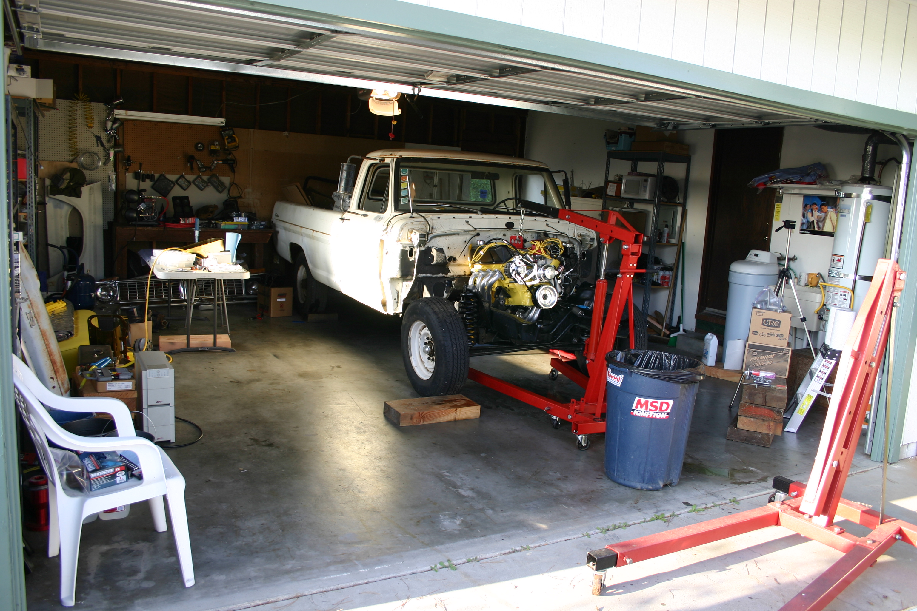

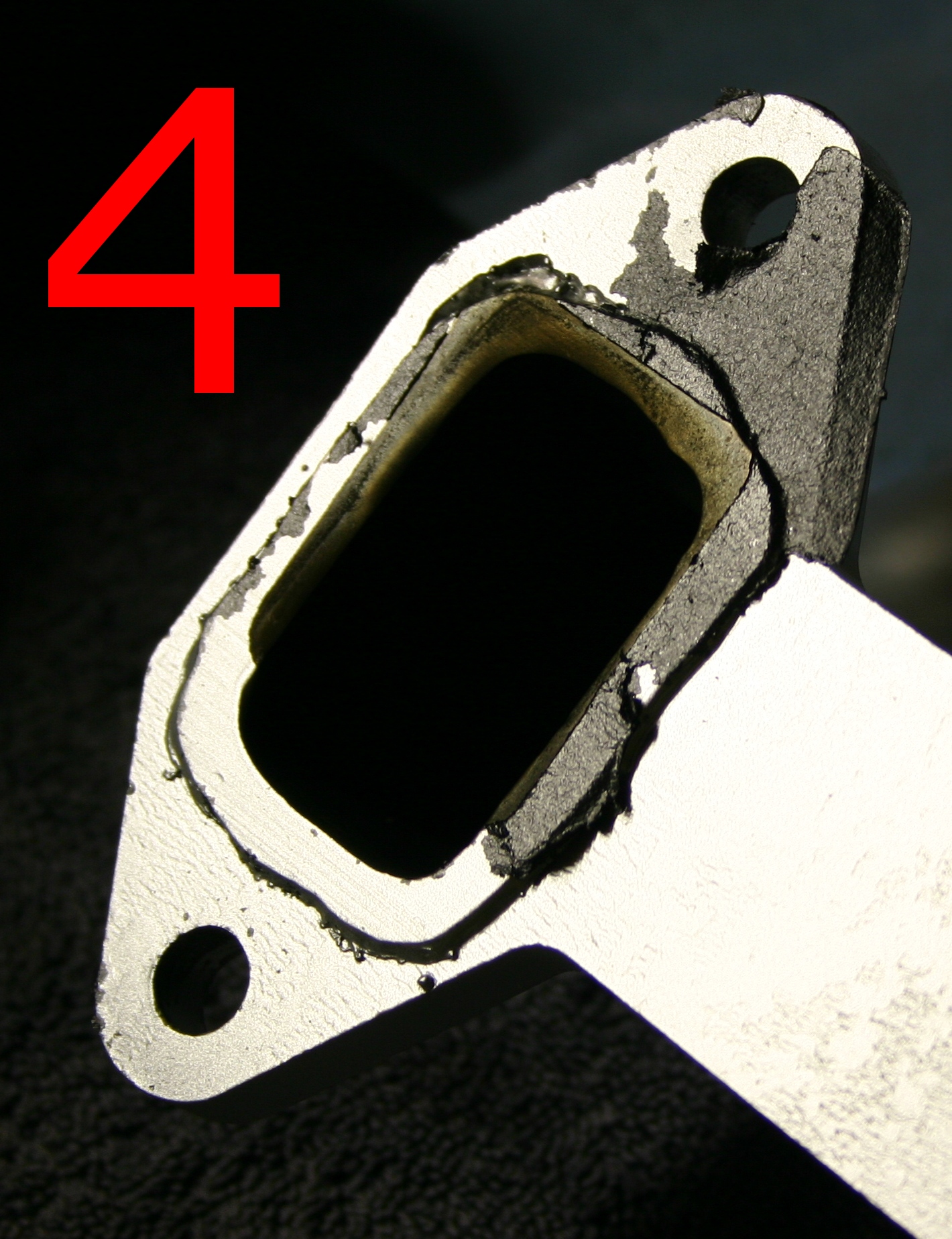

This afternoon I emptied out the back of my work truck in preparation to haul the motor! I took this photo of the overall scenario:
http://www.robroygregg.com/Number50/IMG_4558.JPG

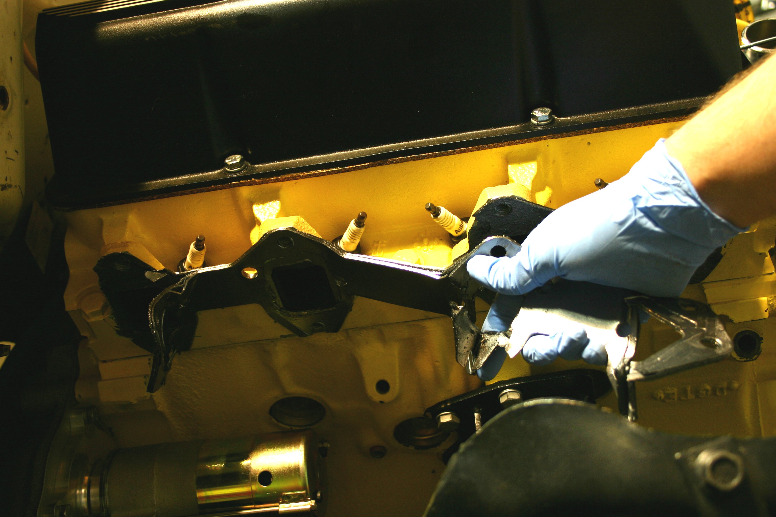

I started removing the headers!
http://www.robroygregg.com/Number50/IMG_4567.JPG
I got the passenger side header off.
http://www.robroygregg.com/Number50/IMG_4583.JPG

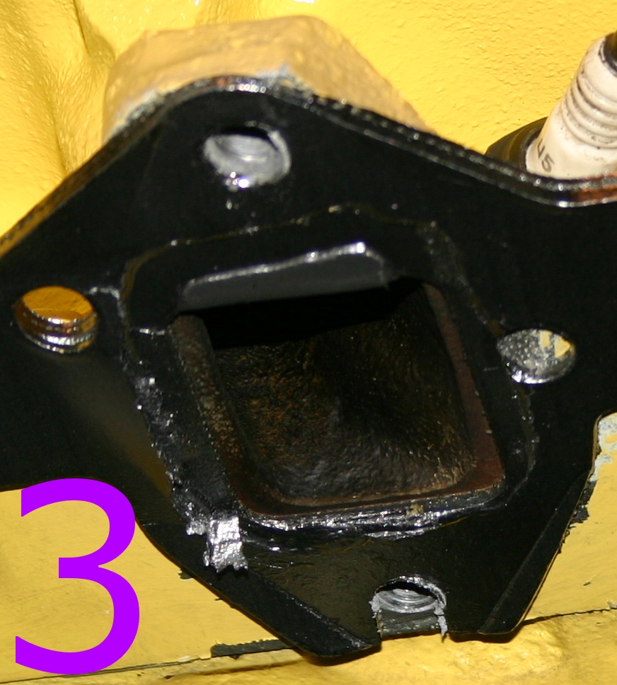

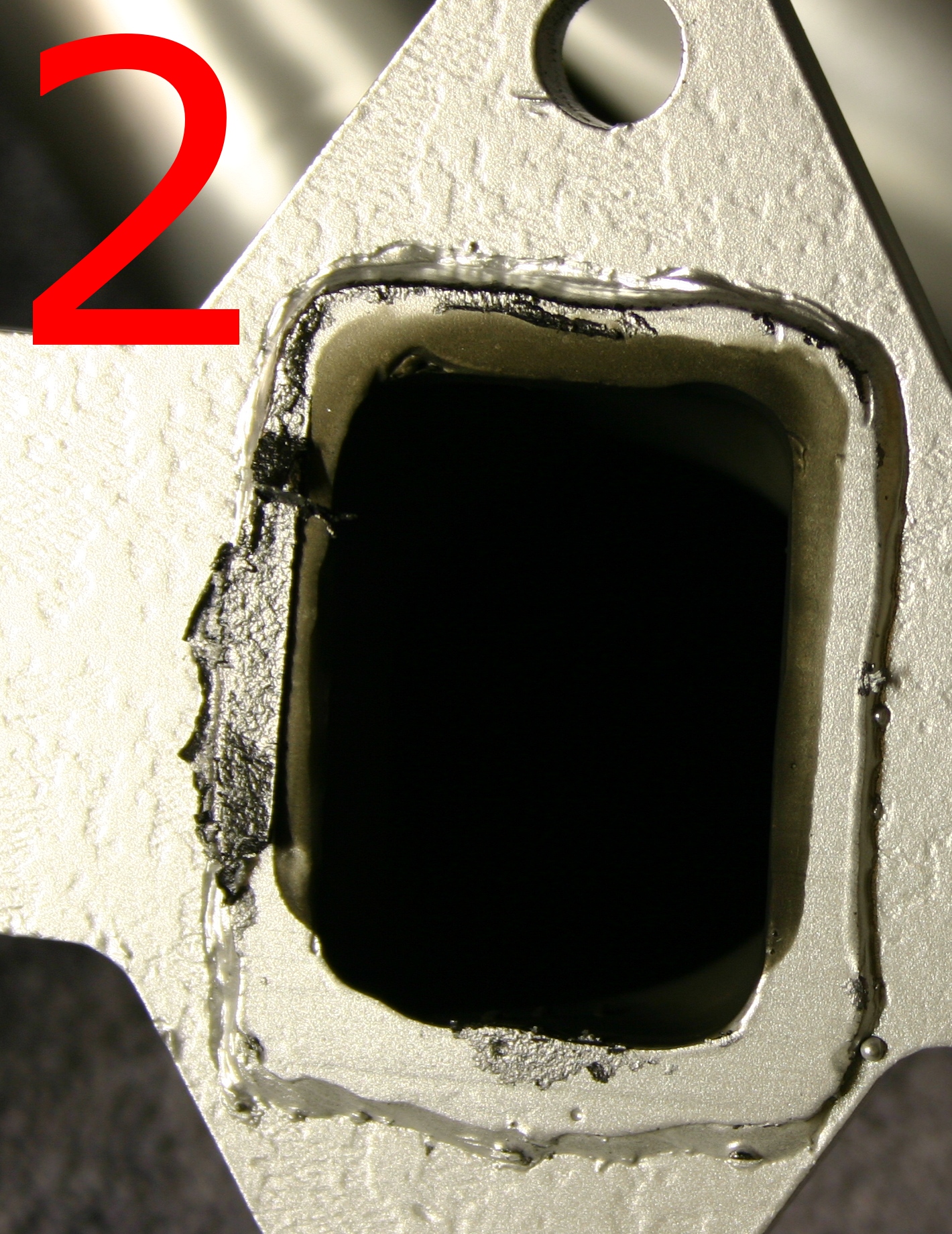

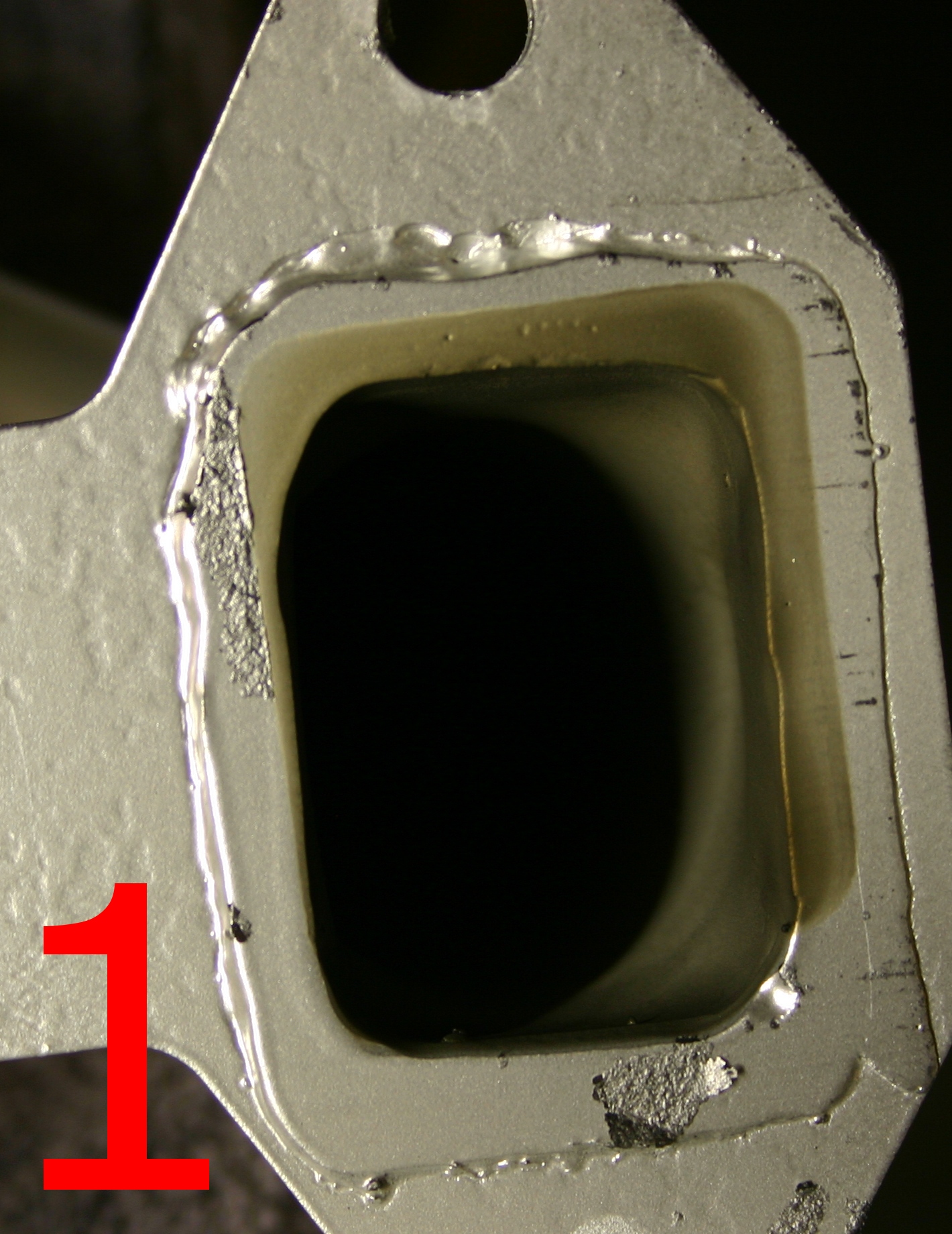

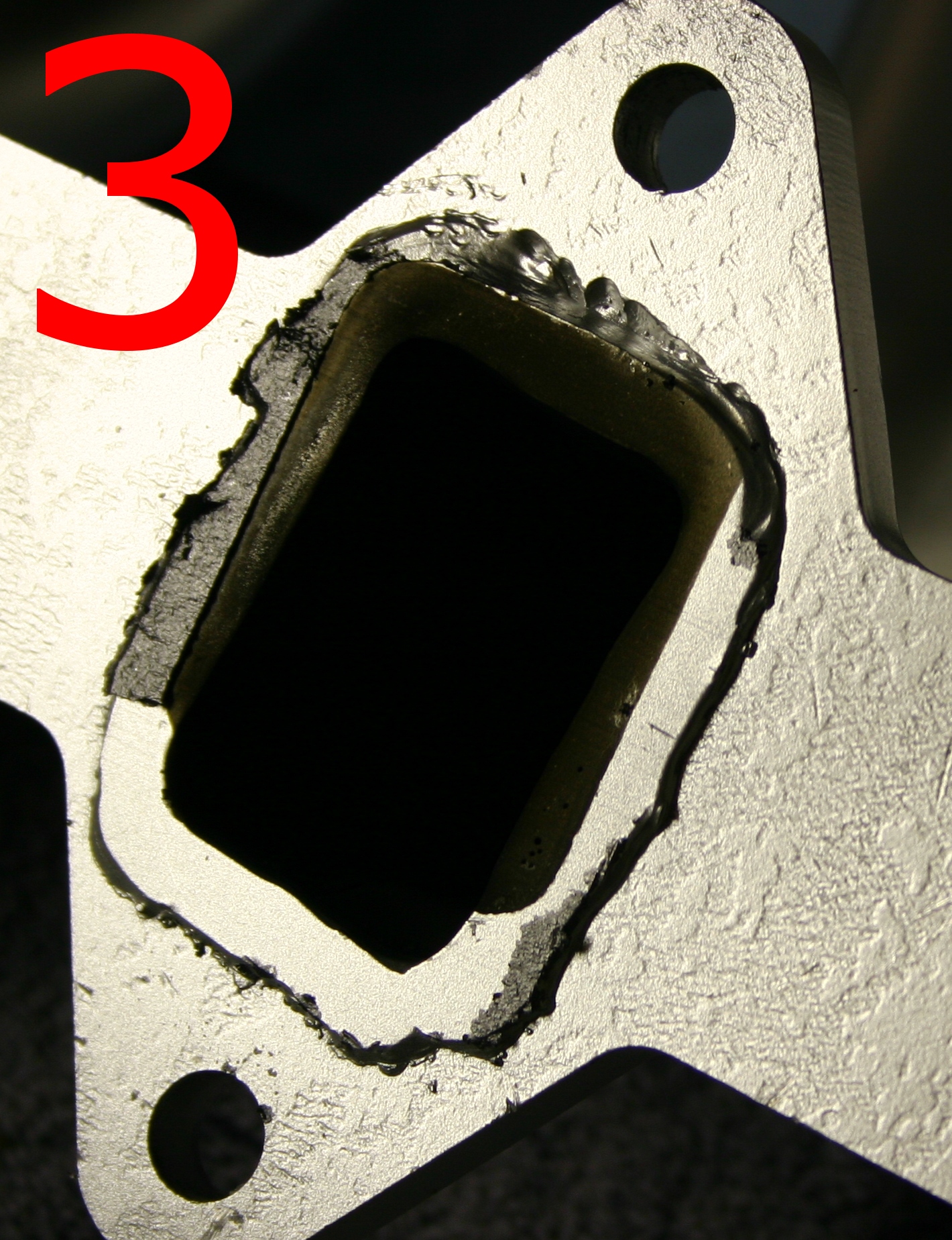

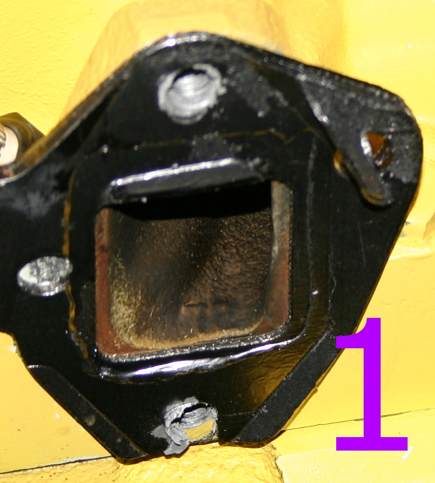

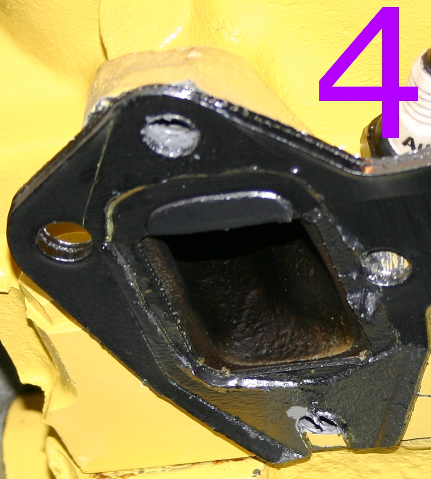

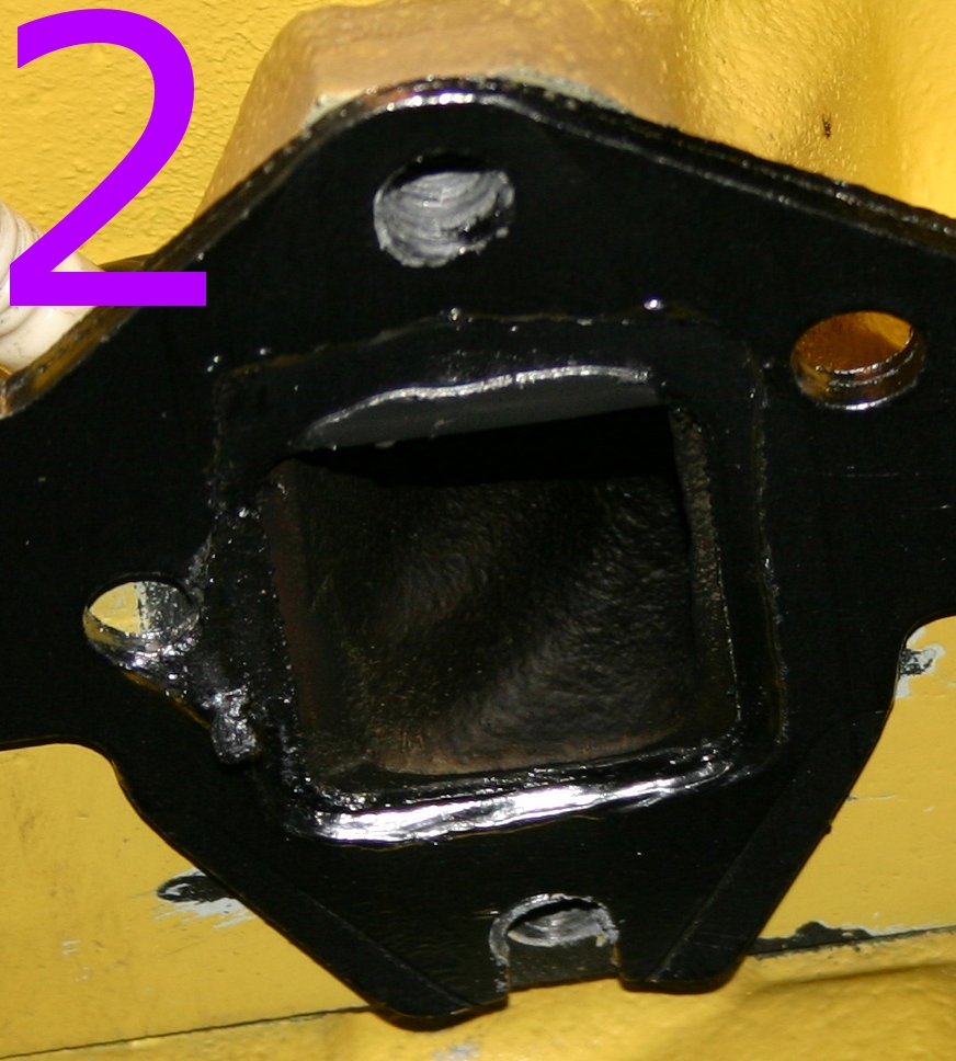

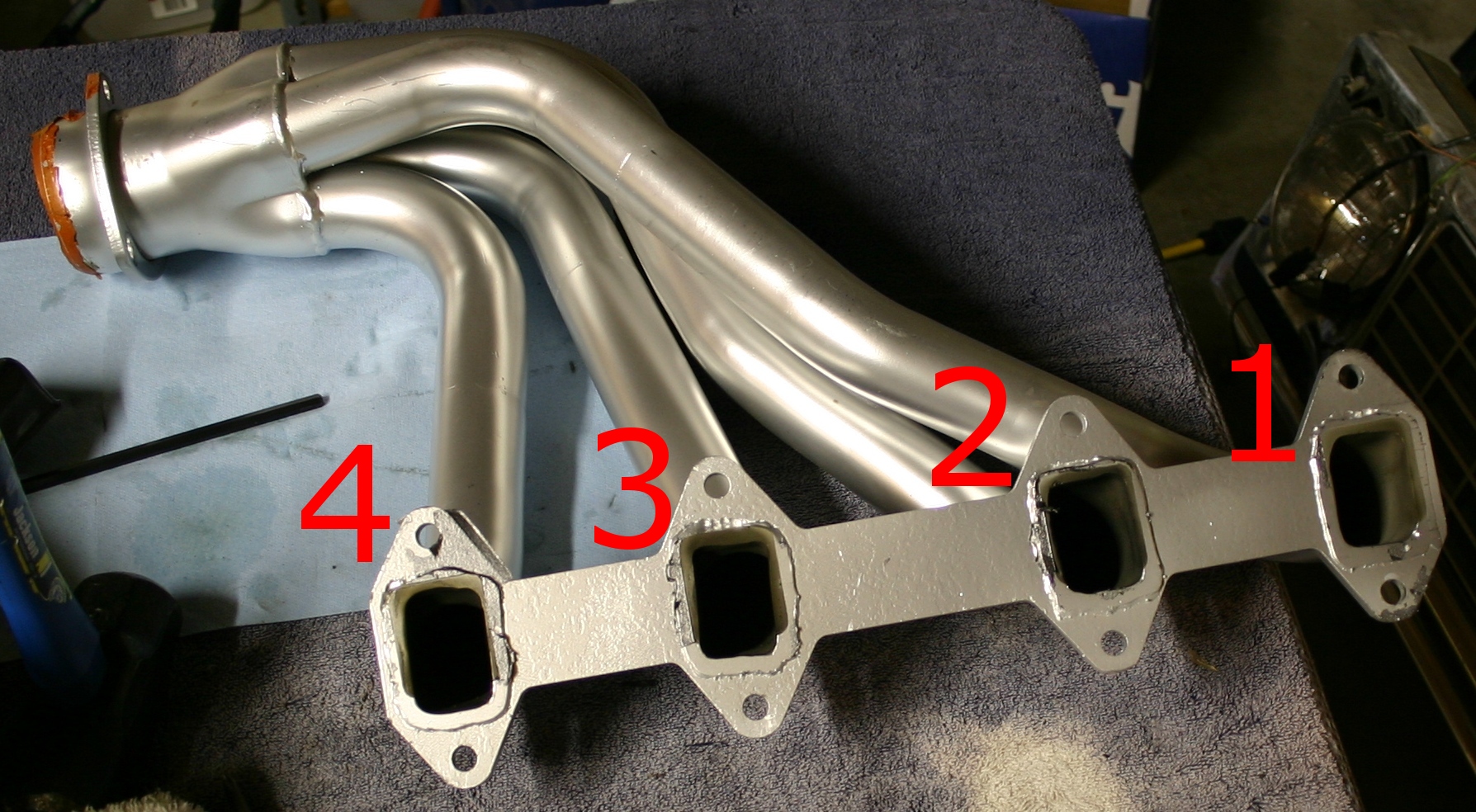

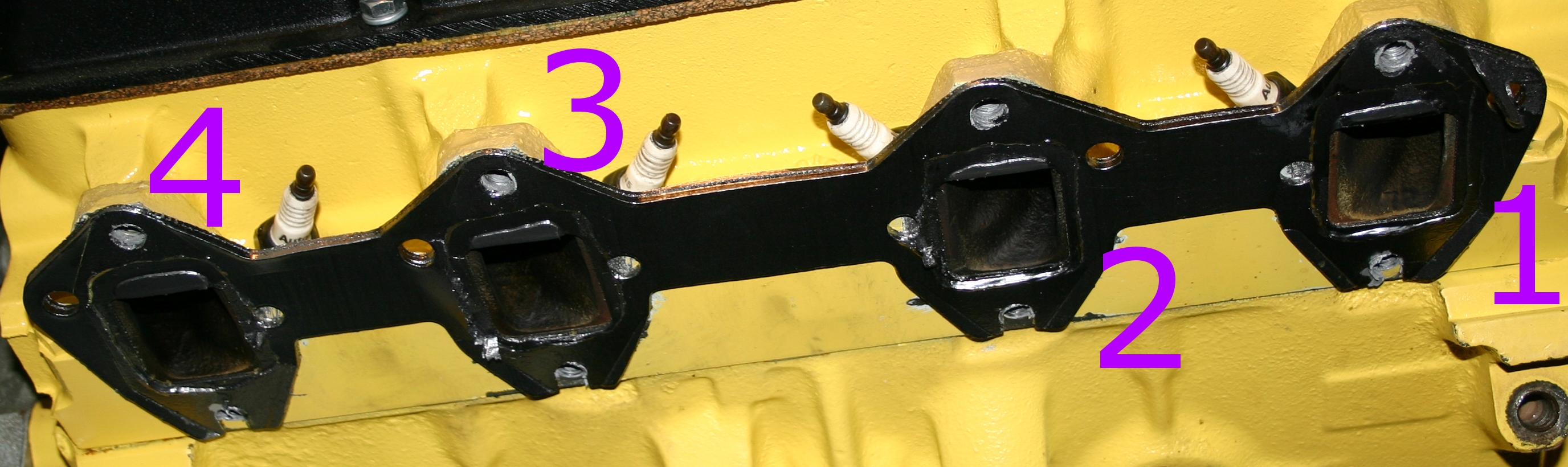

The Remflex gasket was very interesting to look at! Based on what I see, it makes me wonder if the gasket really fits the heads and headers. It's probably right--I remember measuring it pretty carefully, but it just looks like an imperfect match somehow.
Or maybe I just over-tightened the bolts. The gaskets aren't supposed to be pressed down very hard! I'll make them less tight next time.
The number in each of the photos below correspond to the engine cylinder numbers. I put them in there so I could keep track of which photo went with which cylinder, and to make it easy to match them up (so a photo of the gasket on the head could be compared to the same port on the header).
Here's an overall view of the header, just for visual orientation purposes:
http://www.robroygregg.com/Number50/IMG_4569z.JPG
And an overall view of the head, for visual orientation:
http://www.robroygregg.com/Number50/IMG_4580z.JPG
Now let's look at each port up close, on both surfaces.
The first two ports:
The second two ports:
Pulling the gasket off the head. I'd hoped to re-use it, but there was no way. It really came apart! Oh well, it served well during its long, ten minute life. The gasket's on the concrete floor on the right. I would have numbered the ports, but I lost track of which way I set it on the floor! And it's symmetrical, as far as I can see.

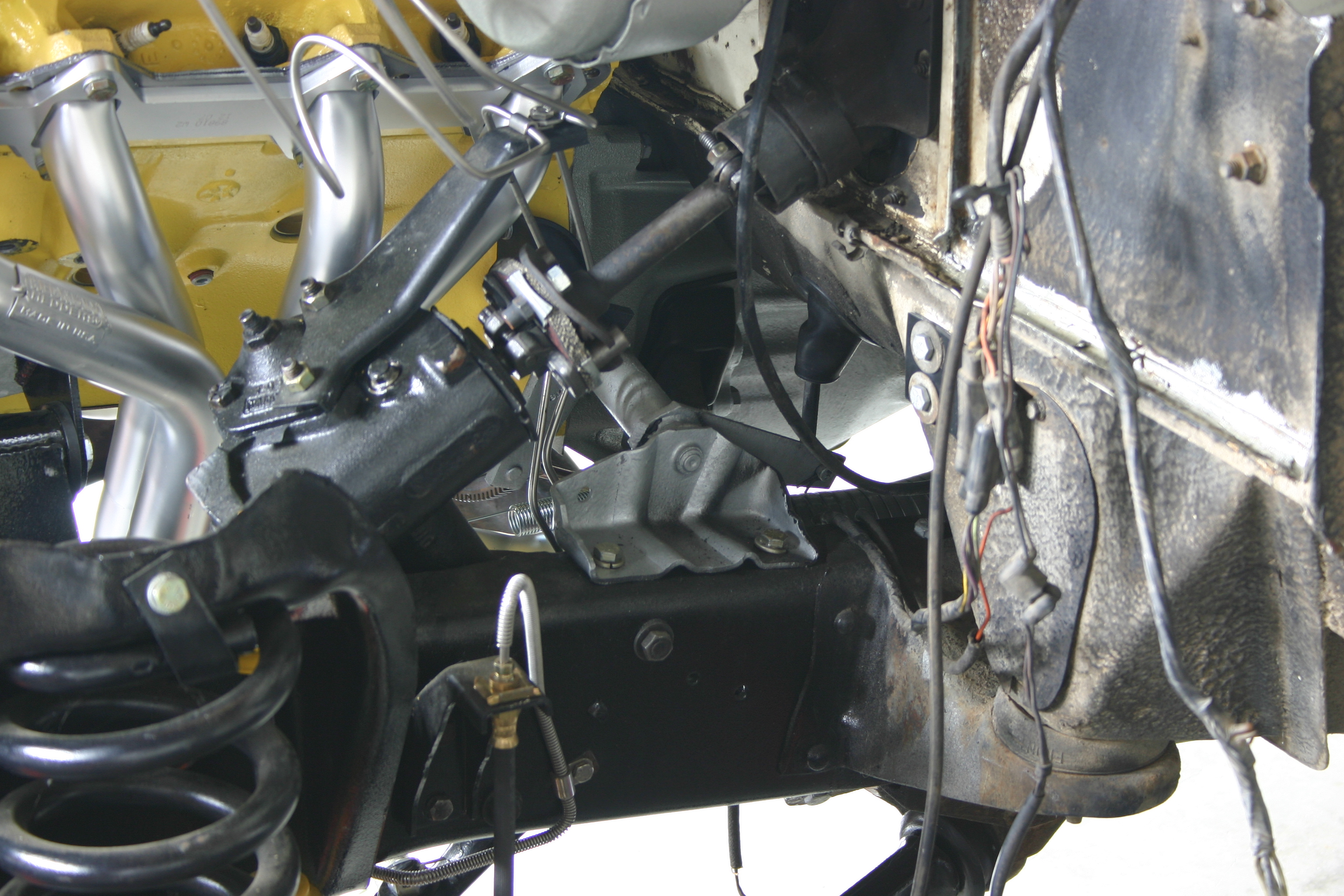

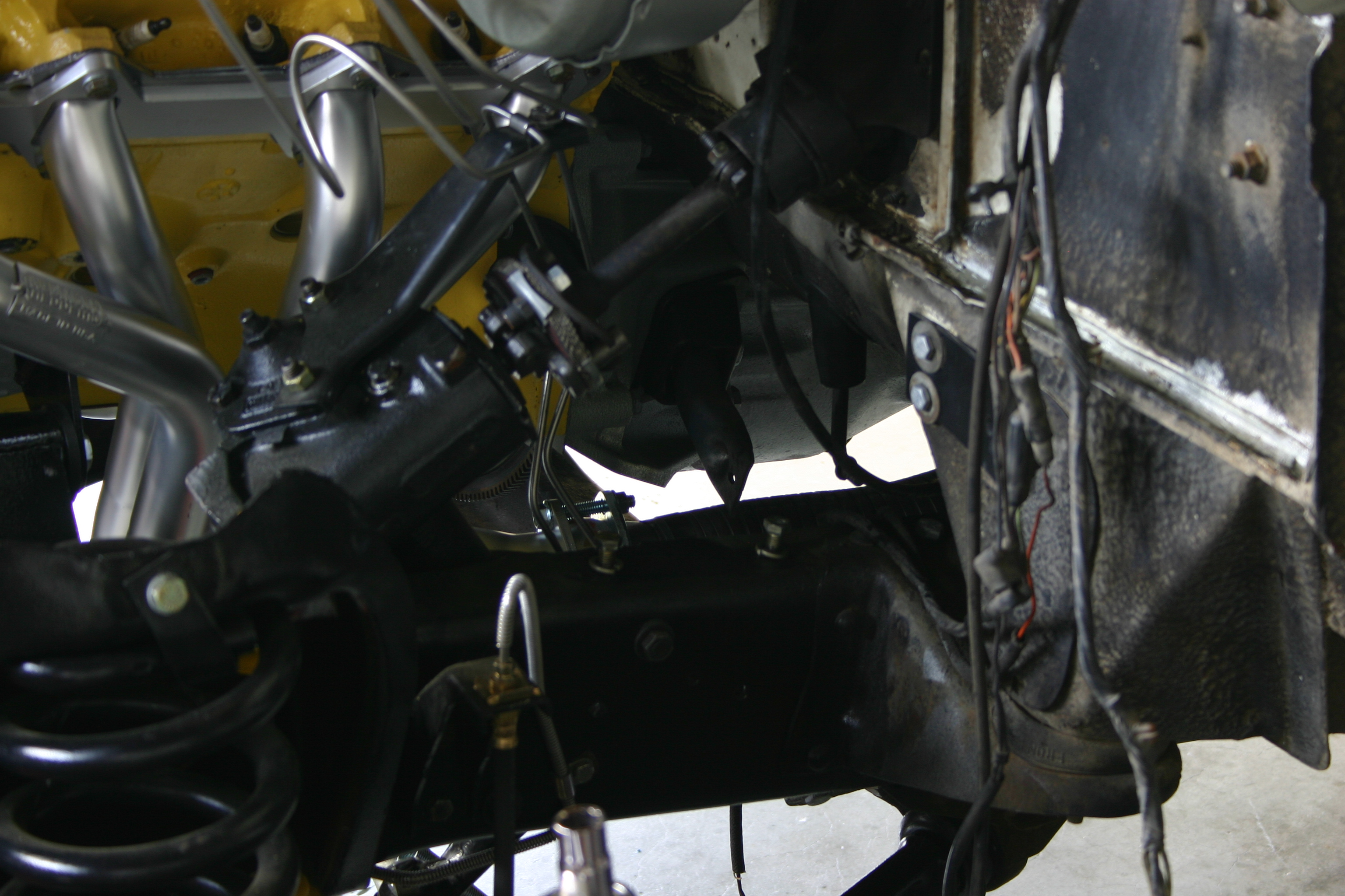

I really needed a pickle fork to get the steering linkage out of the way (so I could remove the header from the under side), but I decided to improvise by tapping on the end of the threaded tie rod end with an extension. This worked last time! But not this time. Tomorrow I'll pick up a pickle fork to finish this off.
http://www.robroygregg.com/Number50/IMG_4586.JPG
Thanks for reading and for the truly outstanding advice!

Hi Kasie and Fordman, thanks for replying!
fordfriend wrote:I hadn't realized how much work you've done out in the garage today!
Thanks! Yes it's going well out there. You should come check up on me more often, unless you're scared that I'll ask for help with stuff!
fordfriend wrote:The radiator holster (front sheet metal panel) was probably one of the first things you took off, but I only just noticed it gone in the pictures!
"Holster" is a much better word than "support," isn't it?
fordfriend wrote:Yea, #50's engine will have around 436HP, but I think you must be doing the work of at least 5 horses out there!
Thanks! I hope your horsepower prediction is close! Perhaps after being "reborn."
fordman wrote:i like the yellow enigne it makes it stand out. plus if you are ever workign on it or around it later on. you will be able to see better than you would if it was black or factory blue.
Hey Fordman, that's right! It's a lot easier to see in the evening and at night, I suppose.
Robroy
