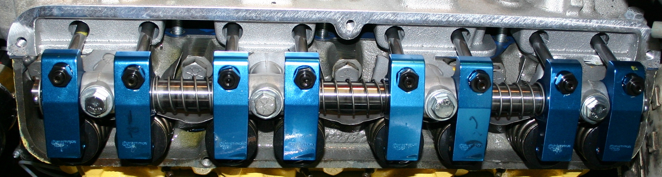

  9. While looking at this photo of the driver's side head: http://www.robroygregg.com/Number50/IMG_4405z.JPG, Tom noticed that only one of the bolts holding the rocker shaft down was a grade eight. In his opinion, those bolts should all be grade eight--in this type of setup, he's seen problems with grade 5 bolts.
  10. Again in the same image, and in other images of these heads, Tom noted that the pushrods don't have enough clearance with their passages in the intake manifold. They're too close on the bottom, and that could lead to problems. He would assemble it differently to place them squarely in the middle of those passages.

A week ago I finally fired up the engine, and heard a loud tapping sound! The crankshaft was eating the edge of my windage tray. It took me about ten minutes to locate the source of the sound, so the engine ran for ten minutes total (mostly idling).
I got the area pulled apart and found some metal shavings in the oil pan. Furthermore, my oil pump was all scratched up inside.
Although a dissection of the oil filter showed that it did its job extremely well, I did find some metal shavings in oil pools up in the heads. I'm not if they came from the windage tray or not, but they were up there.
Here's a photo of the left head (I don't think you can see much, but it might give you an idea about the parts used in the engine):
Here's a photo of the biggest pieces of metal I found on the right head:
http://www.robroygregg.com/Number50/IMG_4350z.JPG
http://www.robroygregg.com/Number50/IMG_4356z.JPG

Tom Lucas replying to Robroy wrote: Hi Robroy,
Here is a follow-up on our phone conversation!! Sorry about the problem you encountered!!
Well there are a few items here that need to addressed. Any loose metal debris in a motor while running can have detrimental effects on piston skirts, cam lobes, oil pumps and timing gears/chains. If the metal shavings reach through the filter and into the oil galleries due to either the filter being of low quality or if the filter was bypassing, then bearing damage will ensue!!
Usually, the filter will due its job for a good period of time, if the debris is not too heavy.
Big pieces of metal cannot make their way up through the filter and into the oil galleries and past the rocker shafts. The debris would stop at either the rocker bolt feed, or try to get past the main, rod, or cam bearings. Any debris that makes its way past the filter will damage the bearings, but I don't believe that this happened in your case, but only inspection will verify this!!!
Since there was a lot of debris on the pump side of the oil filter and the filter looked clean on the motor side. It's probably safe to assume that the filter did its job. That does not clear the motor of any problems from the loose pieces. They can suspend in the oil and cause damage to the pistons, cam, etc. The cam/lifter is the biggest issue here and biggest potential problem.
