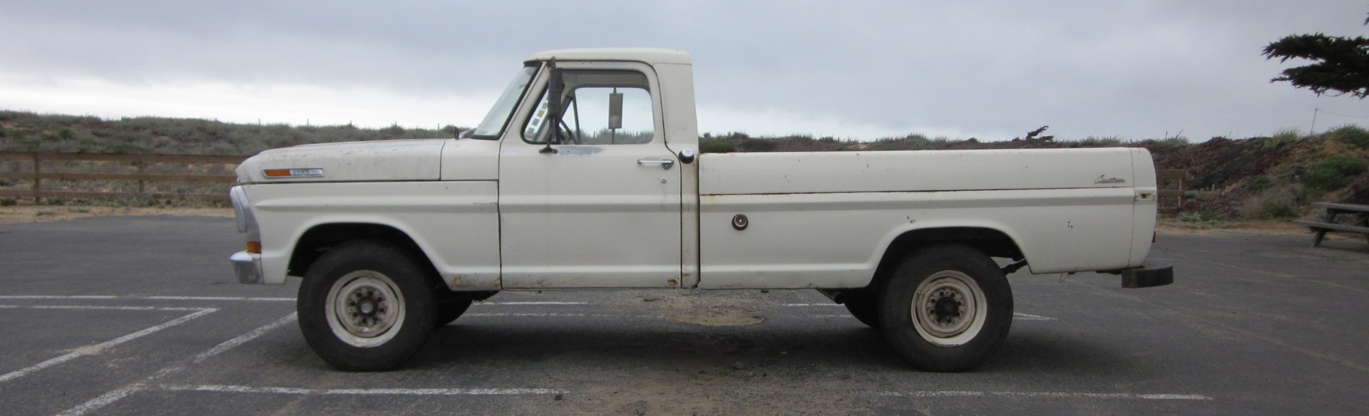

Its even stance is a result of its new springs. I actually couldn't find any pre-made springs that were an exact match for what it had from the factory, since its 8,100lb GVW rating was unusual, but I wound up using springs designed for heavy Dentsides. The fit was OK but not perfect--I wound up having to make my own lower spring retaining plates to keep them in place, since their fit on the bell-shaped cup wasn't as good as the OEM springs.
I went through a few different spring types before finding one that seemed like it would work, although they still didn't fit "like a glove." I might re-do this some day. Here's the thread:
Will '73-'79 coil springs fit my '72 F250? (8,100lb GVW).
One more note: the alignment shop told me that my camber's a few degrees off still. I'm hoping that after driving the truck a few thousand miles it will settle down and get within spec', yet that remains to be seen. Considering that these springs weren't an ideal fit, I'd rather not have the beams bent to accommodate them.

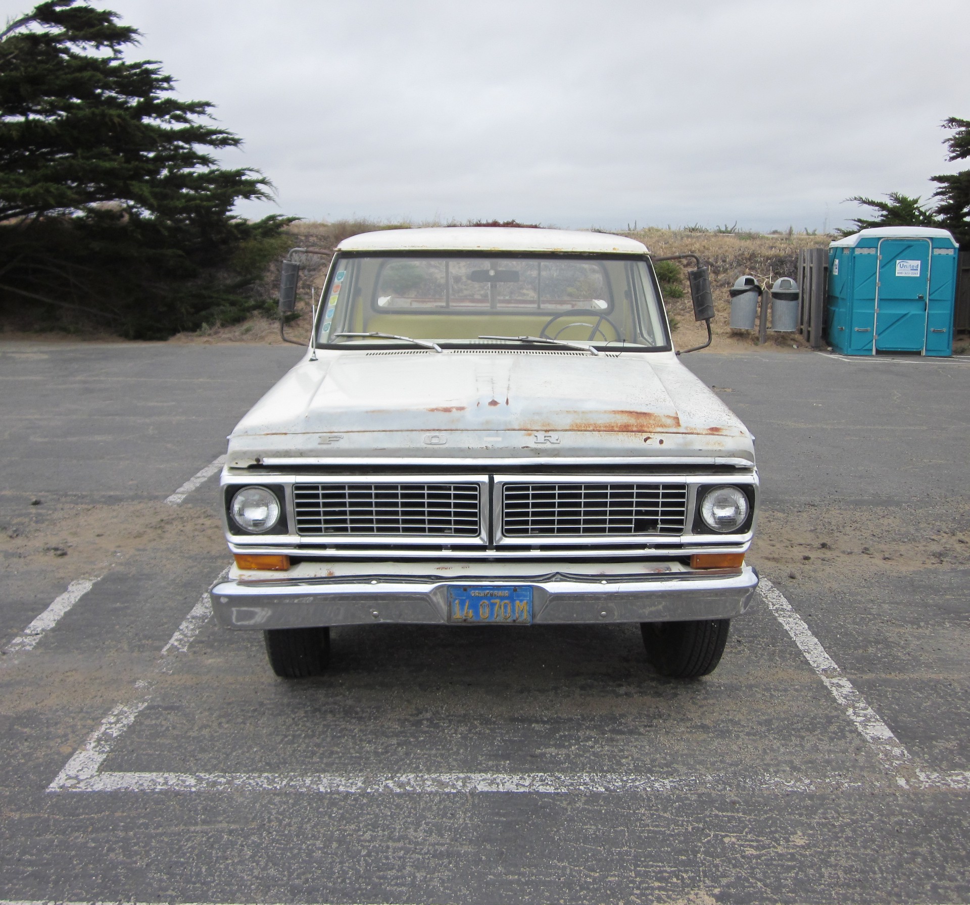

Kasie's preparing for the Santa Cruz "Warf-to-Warf" race in July, and a half-marathon in Moab, Utah this Fall, so we took #50 to the Fort Ord Dunes State Park yesterday so she could go running. The park's about twenty miles from home. Meanwhile, I had some time to drive #50 around in big circles and tinker with it.
The park's a beautiful and unusual place even on an overcast day. There are enormous sand dunes right at the water's edge, with paths leading down to the beach through them.
#50 ran well!!!

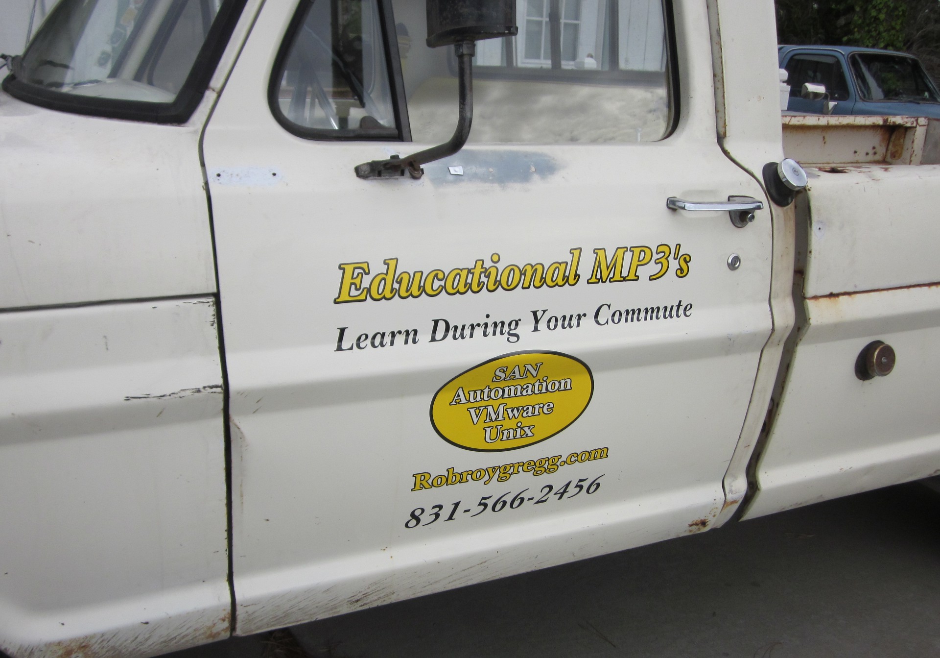

Today's Updates:

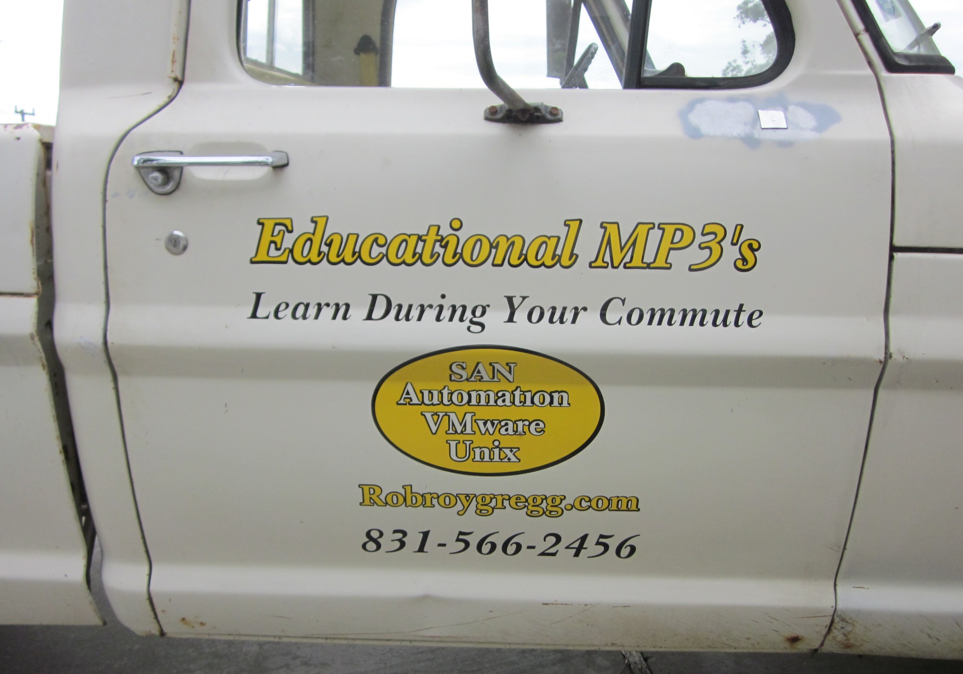

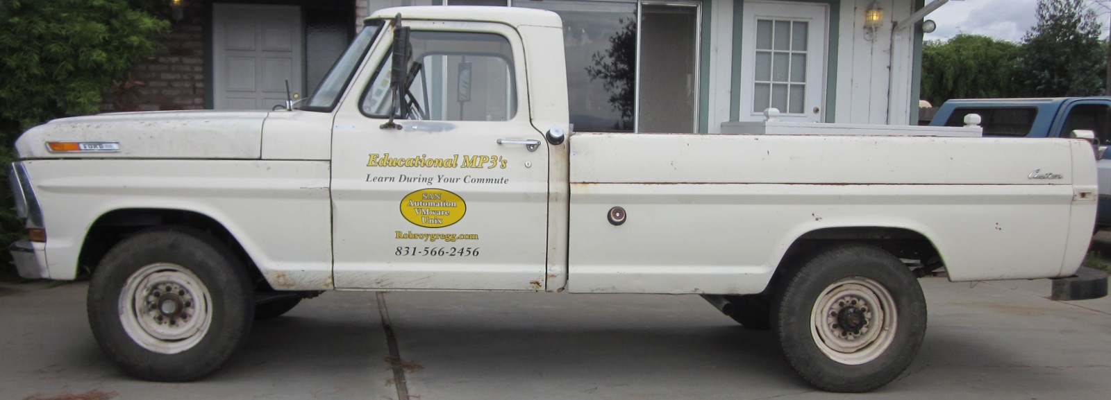

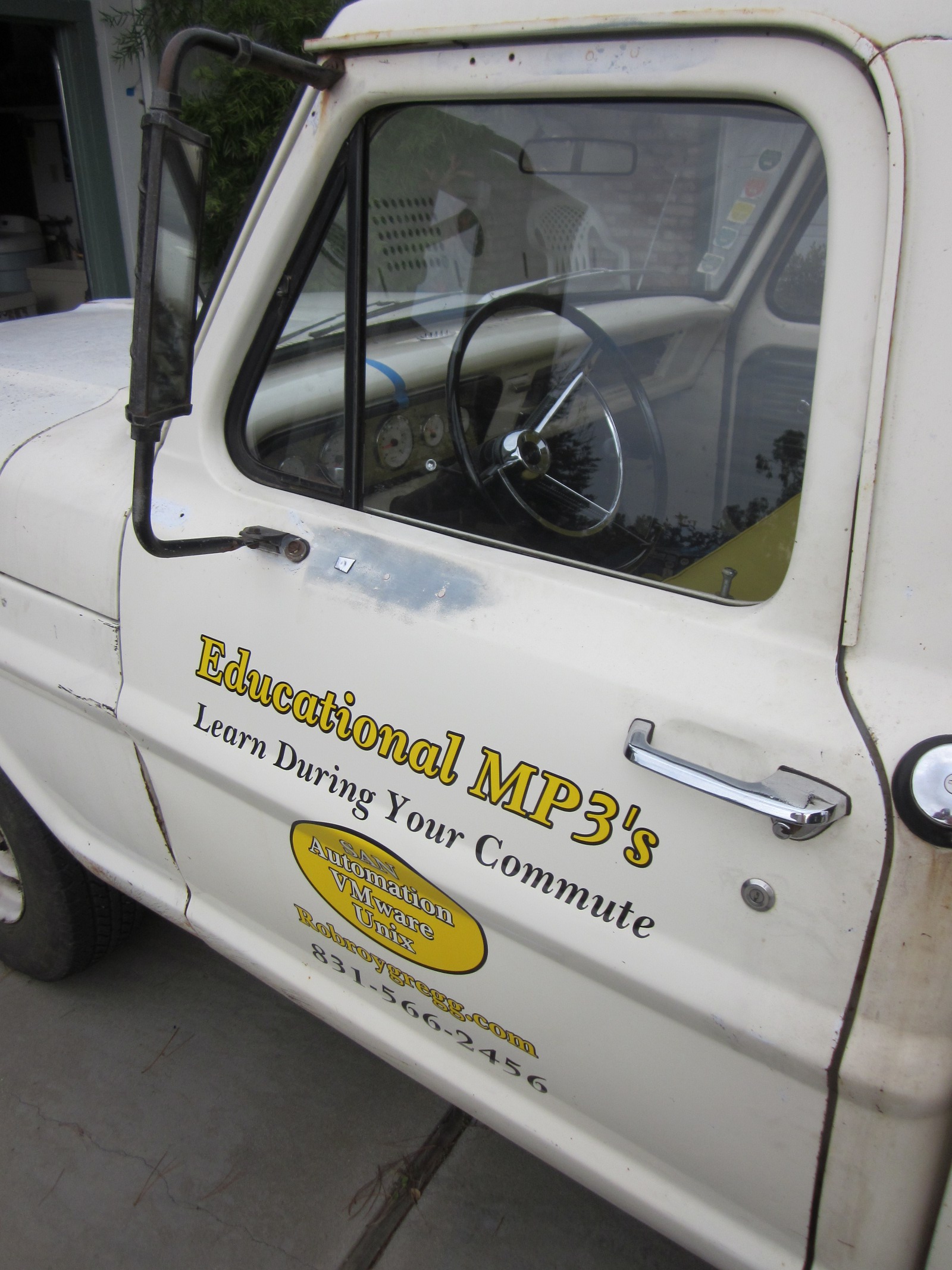

I've taken #50 on several >100 mile test drives over the past few months, and it's really a champ--especially driving up steep mountain roads! Also, I got to ride passenger in it for the first time ever on October 29th, when Rich (1972hiboy) and I took it for a cruise. That was a lot of fun!!!
Last night I finally got signs for my business installed on its doors! I hired Klay Schott at Safari Signs and Graphics to make these vinyl signs and put them on. He had to clean and buff the door skins to get them to stick, but I sure am happy with how they came out! His bill was $160, which seemed like a great deal to me.
Klay showed me some of his personal and customer projects and I was really impressed! One of the most impressive was a museum-quality restoration of a 1914 race car, which he pulled out of a local field where it had sat for ninety years! He had to search around in the dirt with a metal detector to find all of its parts, including the gears out of its differential. Today it's an incredibly beautiful antique that he actually races in antique car races.
I was going to wait for a sunny day to take some nice photos of these, but I wasn't patient enough for that, so here are my new door signs (click to enlarge):
